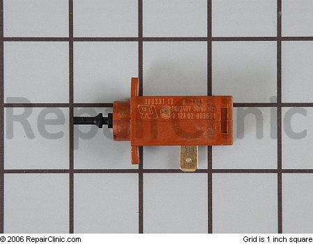

If you see any burnt spots on it, The root cause of the main control board going out(burnt spots) is the door wax motor. You will need to replace that as well.
Unplug or turn the breaker off to your stack, then here's the repair manual for your model that shows you how to access the door wax motor: www.applianceblog.com/manuals/16009127.pdf
Here's the wax motor kit for your model you can order here:
Manufacturer part number 12002535

Ok, Brian, no I'd get the wax motor kit.
I found a post by Christie where she replaced the wax motor kit and it fixed it: FIXED Neptune MLE2000AYW - Works but stops between cycles
Read all that thread.
Wax Motor 12002535
Yes, you'd need a new boot assembly as well.
You can order it here:

I ordered the wax motor kit and will give it a try... it's an inexpensive enough part swap. Our situation is a little different than Christies, in that our washer never finishes a cycle after you push the start/stop button again. Can't keep limping it along...it keeps quiting after ~ 30 seconds every time. The door lock light does come on...but sometimes I've seen when it quits the door light is off..and on light is still on..but washer not running.

:) IT WORKS - PROBLEM FIXED !!!!!! :)
Ordered the door wax motor Monday morning, it arrived today (Tuesday), put the part in after work and we're back in business!
My wife & I were crossing our fingers up to the 30 seconds when it typcially stopped, but it kept on going and the load is almost finished now. I assume that the door must not have locked so the washer kept stopping the cycle.
