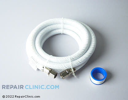

I always use 3/8" nylon water line tubing that connects to the water inlet valve and has the 1/4" compression fitting already on it.
Here's the one I prefer:
1/4 Inch Water Line Installation Kit 5304493869
All IN-LINE filters MUST GO BETWEEN the water supply line from your house, to the water inlet valve where it hooks up to in the back of the refrigerator.
