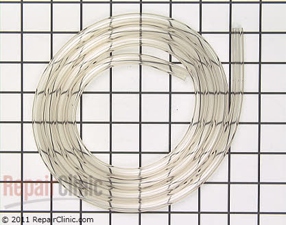

Here's the pressure hose for your model:
Hose WP353244
