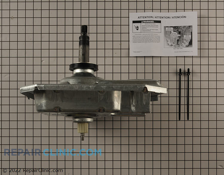

My Maytag washer MVWX655DW1 is approaching 3 years old. This past February it began having problems with the agitation mode and ended up needing a new hub assembly W10528947. It worked like new after replacing the hub but that one lasted only about 3 months and then the same symptoms as before led to another hub. That hub last about a month and now I am replacing the hub every 3-4 weeks.
I have mostly used genuine factory hubs as well as a cheaper option off Amazon but the results are the same. I have now used eight hubs and am considering buying them in bulk. Our household includes me, my wife, and a son. We run the washer twice a day seven days a week to keep the loads small.
We are washing bath towels, sheets, and clothes. No heavy bedspreads or quilts or big loads. I replaced the splutch assembly recently to see if that might help, but it did not. The hub stripped several days later at the end of the 3-4 week mark. Besides this hub stripping issue, the machine works perfectly. It sounds normal and has no leaks and cleans the clothes when it is working.
Can anyone help me solve this issue? Any help is very appreciated.

I wanted to circle back to this since it has been a few months. I replaced the splutch assembly back in late November 2020. The hub, which normally stripped after about a month, last almost 6 weeks, then it stripped also. Since then I have continued to use a new hub about every 4 weeks. I am attaching a photo of the shaft. You can see how worn the splines are in the lower portion. They are sharp to the touch. This is what makes contact where the hub strips. Any advice is appreciated.

Do you have the exact same model MVWX655DW1 ?
Your transmission shaft is the problem causing it to continually wear out the hub. You'd need to replace the transmission to fix it permanently.
Here's the transmission(gearcase) for your model: W11454734 Gearcase

You are absolutely correct, on yours you will need to replace the transmission to fix it.
Here's the transmission for your model:
Transmission W11454734
