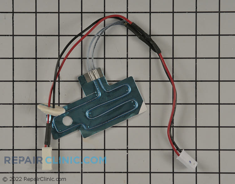

139,461
I'm sorry to hear that happened to you.
This is very mysterious to me why the fill tube keeps freezing up.
Unless its intermittently working then stops working.
Here's the fill tube heater for your model:
Here's the photo of it:

I replaced the fill tube heater ~one year ago. I'm thinking that my water/ice valve is slightly leaking allowing a little bit of water to collect, and freeze, at the end of the tube and the heater just doesn't thaw it for whatever reason. It's getting power... I already confirmed that by checking the facia heater. So I've got a new valve sitting on top of the frig waiting for the icemaker which is on backorder and due "4-14" days. I'll replace them both at the same time.
139,461
Yes, that's what I was thinking too, but I thought you already replaced it, I see that you didn't yet, so hopefully that fixes it.
Here's the water inlet valve and video below, in case others need it too:
