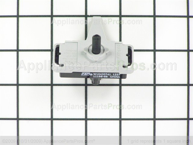

Wait, I forgot another part that would cause it to NOT start, which is the Push-to-start switch. Unplug your dryer and ohm test it for continuity with the button on it pushed in.
Here's the Push-to-Start switch for your model:
Switch-Pts WPW10420741
