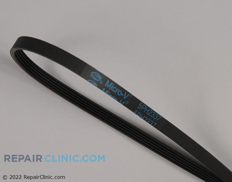

Check the idler pulley where the belt rides on to make sure it turns freely both ways. Also check your drum rollers to make sure they turn freely both ways too, and that they are not starting to wobble and wear out.
If the idler pulley and drum rollers are fine, then the belt just wore out.
Here's the belt for your model you can order:
Drive Belt WPW10205415
