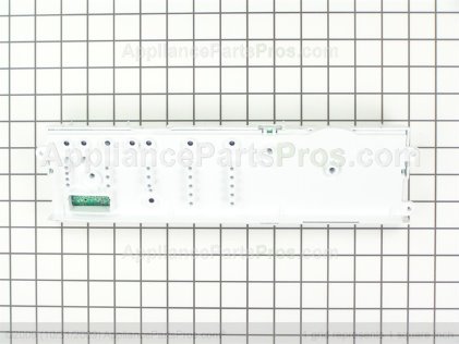

No voltage at solenoid valves in Kenmore 417.94092500 GAS dryer

Gas dryer is running fine display and door switch are working but no any volt at solenoid valves and dryer is not heating . The Valves , temp sensors and ignitor are in test connectivity Model is Kenmore, Expecting control board but needs expert opinion from Jake

Thanks Jake for your prompt feedback and support. I checked already this thermistor it is OK as well I check the centrifugate switch in motor also find OK.
I did not find any volts in connector of solenoid valve. I don't have diagram or service Manual the volt is 120 V or 24 Volts. I am expecting control board relay not sure.
You are our Technical expert and having lot experience than us please advise
