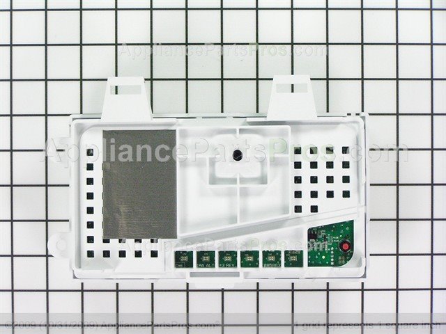

With a voltmeter set to AC, connect the black probe to J2-2 (L1) and red probe to J2-1 (N). Activate shifter motor by switching between Spin and Agitate modes. Energize outputs using Manual Test Mode on page 9.
IMPORTANT: Lid must be closed with Lid Lock enabled to run the SPIN and AGITATE tests.
NOTE: It will take 4–15 seconds for the shifter to change states.
--->If 120VAC is present, go to step 9.
--->If 120VAC is not present, go to step 17.
So you get no voltage at all to J2-2 (L1) and J2-1 (N) on the J2 connector of the main control board?
I set the volt meter to Vac 200 black probe to hole with black and white wire red probe to hole with brown do the manual test for spin leds are flashing but no reading on volt meter
17. If the preceding steps did not correct the problem, replace the main control.
a. Unplug washer or disconnect power.
b. Replace the main control.
c. Reassemble all parts and panels.
d. Plug in washer or reconnect power. Calibrate washer and perform Automatic Test to verify repair.
W11116498 Cntrl-Elec
