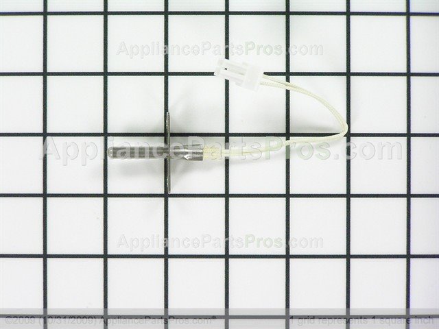

Unplug the range and check the resistance of the oven temperature sensor using a multimeter. You should measure around 1,100 ohms of resistance at room temperature. Replace the oven temperature sensor if resistance is off by more than 200 ohms. If the oven temperature sensor resistance is okay, replace the main control board.
Here's the temperature sensor for your model:
Oven Sensor DG32-00004C
Yes, the main control board you posted in your previous post is the correct one for your model.
That discoloration is normal, I see that a lot on my service calls.
