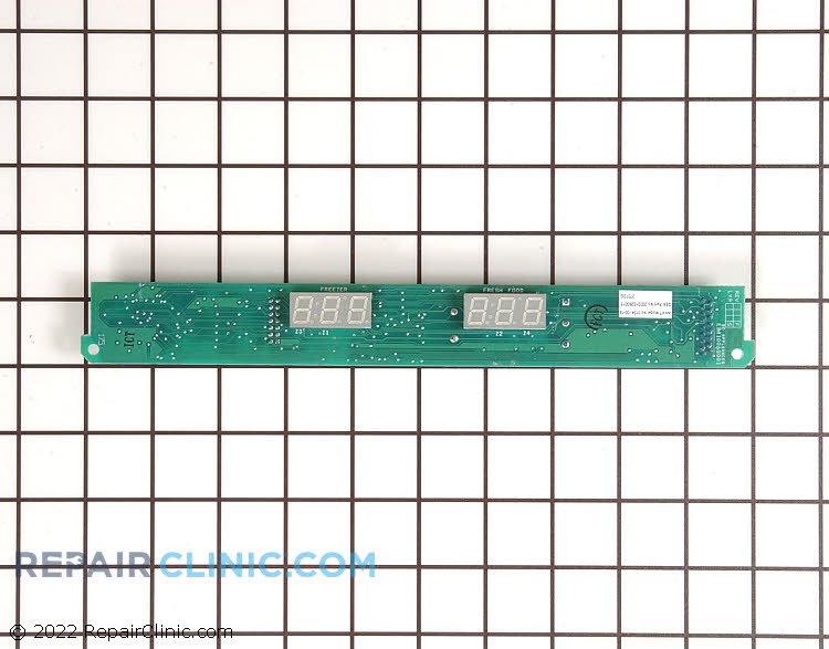

I have a GE Profile, PFS22MIWCBB, side by side bottom freezer. We had a power outage and when power came back on the fridge no longer worked. Inside light is on, nothing on the temp displays and no sounds. I installed a new control board and still nothing. Next step?

Here's the display board for your model you can order if needed:
WR55X10522 Pwb Assembly Display

Thanks for getting back to me. Line power was good. That output at J4-2 and J4-3 was only around 8-9 volts?? I pulled the display board and don't see anything all black and burned, there is a small white spot at R24
