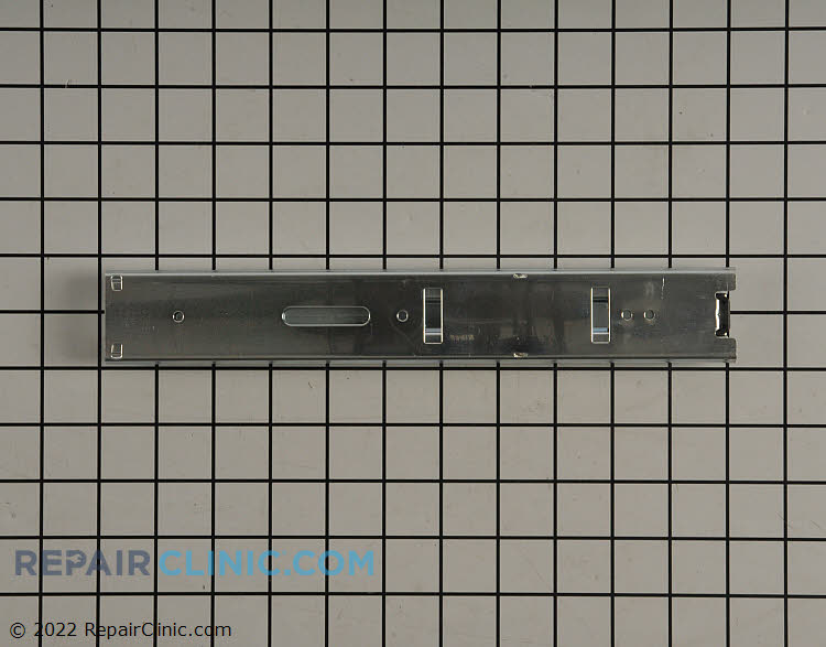

This is a french door GE refrigerator with a bottom freezer. The top drawer in the freezer is mounted with metal drawer slides on each side. The drawer became dislodged from one slide and when I removed the drawer, the left drawer slide came off. The slide has not been damaged, but there are two small (4" x 1/4") pieces of plastic each with 4 ball bearings. These pieces go between the bracket that is attached to the wall of the refrigerator and the slide itself. They keep the slide balanced inside the bracket.
I have not been able to reassemble these pieces with the slide to install into the bracket due to the various "stops" in the slide. Photos show the right side that is assembled and attached and where the ball bearing pieces are. The other tthree pics show the disassembled slide and the bracket attached to the freezer wall.
Advice needed on how to assemble. I'm frustrated and don't want to spend $80 on a repair person for what should be an easy fix.

Is it #521 that is broken?
Since it fell apart I double it would last if you could put it back together.
The slide seems cheaper enough to replace.
No pic LINK> Slide Upper Basket

Yes, that's the part, but it's not broken. It is disassembled. Please look at my pics and you will see that the small pieces with ball bearings just need to be placed on the track.

Sorry to revive an old thread, but I'm having the exact same issue!
lynneburnett, how did you solve this issue?? I'm worried that replacing the part won't even work because part #521 isn't even the issue. It appears that _connecting_ #521 to the actual freezer side is the problem!

For any future visitors to this thread:
Per someone I spoke to at the official GE parts store, part #521 (WR17X21923) does in fact include the bracket that attaches to the fridge (depicted in the attachment with the name "20181130_122617.jpg"), though all the pictures online do not make this fact clear.
I will order this part once it becomes available. (Currently out of stock.)
