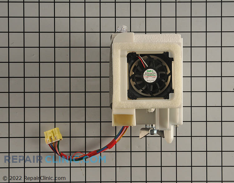

As the subject says - ice maker freezes up every few weeks. Not the water line - that's fine, water dispenser works all the time. The ice maker itself, where ice cubes are dropped to the bucket. If you don't catch it in time, the bucket gets stuck to the ice maker.

Replace ice maker. Install Y clips. Silicone bottom left seam to prevent air leakage.

An update.
New ice maker is also updated.
See the new clips installed on the right side of the pic.

I received the part today, thank you for fast shipping!

Why does it keep freezing when the ice maker is off
Has a refrigeration system line in there.
In addition, every now and then I hear something in the ice maker working or trying to work, like something is trying to spin. It stops as soon as I open the door and resumes when I close it.
For sure in the ice maker itself? There is also a fan behind the ice maker.
LINK> Auger motor
