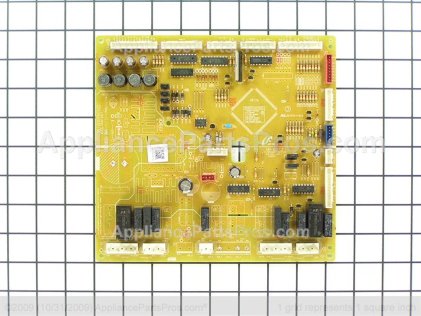

Can I run two thoughts by you?
  1. The control board I put on it was used from eBay. It was $80 vs $150 new. When I installed it, the interior lights wouldn't turn on, so I knew at least that was bad on it. But I only left it in for a day and didn't see any changes to the temperature reading, so I dismissed the control board as the issue. I returned the board citing the inoperable interior lights.
    However, the more I'm thinking about this, I assume the temperature sensor is just connected directly to the control board, with nothing in between. So if the temperature reading is wrong, it has to be either the sensor or the board. The sensor was replaced. Do you think I should just buy a brand new control board?
  2. When I pulled the temperature sensor out into the box, I left it so that it hung some. So it was probably 2" from the top and 3" from the back. That's as far as the leads would go. This morning, I decided to tape the senor itself directly to the top of the fridge, thinking it'd be warmer up there. And the fridge temp readout did move up to 35° (up from 34°). Could I cut and splice the sensor to give it longer leads and route it up to the front of the box at the top? That's about the warmest part of the fridge, right?
That is correct.
Samsung DA94-02680A Assy PCB
You said you replaced the entire assembly, it comes with the sensor already placed where it should be.

Thanks for your reply. I did fix it. I decided to try a control board again. I purchased it used again, from from a seemingly more reputable source. As soon as I installed the new board, the fridge temp reading matched my sensor and I haven't had a problem since.
134,144
Redmond, Oregon
Excellent, glad to hear that.(y)
