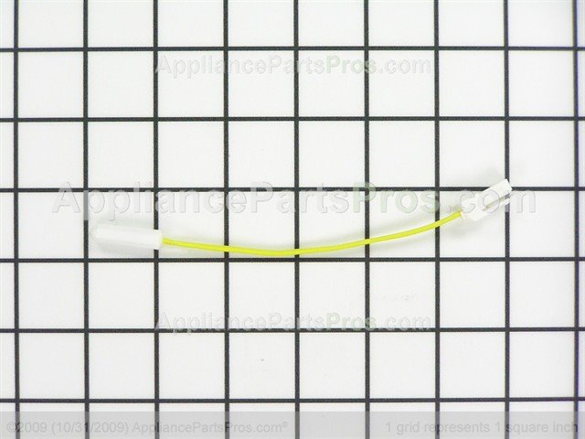

Ok, It's possibly the refrigerator temperature sensor(aka thermistor).
To ohm test it--->Make an ice slurry. To do this, fill a cup with ice (preferably crushed), then add water and a teaspoon of salt to make a slush. Mix thoroughly and allow to sit for 2 to 3 minutes. This will give you a 32°F reference. Now, lower the thermistor into the mixture and leave for about 1 minute, then check the resistance. It should be very close to 13,300Ω. Before reinstalling the sensor, be sure to rinse it with fresh water and dry it.
Here it is for your model:
Thermistor DA32-00033C
This video shows you how to access it:

Thank you for the help! I just tested it in cold ice water and it was reading 13.1 when set at 20ohms. So it sounds like it is working correctly.
That's odd, That's all I know that would cause this issue.
Hopefully another tech or member that's seen this problem and fixed it can shed some light on this issue.
Jake it actually is working now! We just had to give it a few days to adjust! THANK YOU SO MUCH!
