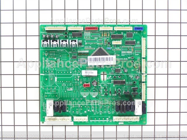

Yes, the control board PCB is the culprit
Check to see if you have any numbers after the final "XAA" in your model number.
Model RF4287HARS/XAA-0000 uses this main PCB:
DA41-00684A Assy Pcb Main
Models RF4287HARS/XAA-0001 and RF4287HARS/XAA-0002 and RF4287HARS/XAA-0003 use this main PCB:
DA92-00233D

Yes, I had this same issue in local area with one my local customers, and the new control board fixed it.
Per the model number tag in your photo--->This model then would default to a RF4287HARS/XAA-0000
The control board should have the part number on it too, if you want to verify that.

So I finally got a Chance to work on this fridge (instead of just getting pictures of it).
I’m thinking it’s the inverter board. See attached pics. lol
I’m guessing there’s a chance the control board could be damaged as well. So I ordered both.
I took my chances with used stuff on eBay.
$40 for the control board and $12 for the inverter board. Can’t beat that!
Oh and The guy on eBay said the board you guys recommended is not correct.
So I got the number right off the board and ordered
DA41-00683A. It looks exactly like the one I have.
Or are those 2 part numbers the same thing?
Either way, thanks for the help! I really appreciate it.

DA41-00683A--->No results found on any OEM part sites.
So did you already install that board?
That sounds too good to be true, how can they sell that for such a low price and make any money from it?
Just remember--->If it sounds too good to be true, it usually is too good to be true.
This is the OEM inverter board for your model: DA92-00215C Inverter

But I got it and it worked!
I only replaced the inverter board.
So I still have the main board for a spare.
I’ll attach screenshots so u can see the exact ones I got and the prices.
They were used. That’s why so cheap.
Only 2 things not working now are the ice maker and some of the segments on the front display are not lighting up.
