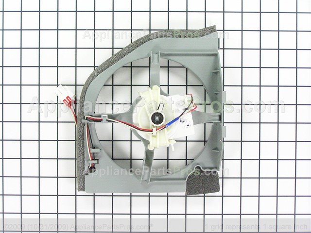

Thanks Jake ! The fan in between the compressor and coils also never turns on in that hour if that’s a clue for anything else.

Hey Jake,
So new fan came in and installed, the 88/89 88 code did not show at initial plug-in. Was waiting for fan to turn on but it did not do so. Checked voltage for all fans. F-Fan = 9.95 , R-Fan = 8.19 , C- Fan 0.05 . Would the next step be to replace the board?
137,440
Yes, the main board is the problem.
DA41-00538A Pba Main

UPDATE: Received new board and swapped it out, fridge has been working well since then. Thanks Jake!
137,440
Excellent Kevin, glad to hear the new control board fixed it.(y)
