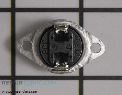

Its possibly your thermal fuse that went out. That also can cause the dryer to not run at all if its bad.
Here's the thermal fuse for your model:
Thermal Fuse DC47-00016A
Once you click on the link to that part there will be 2 videos that show you how to access it and test it. Make sure you disconnect power to the dryer first before accessing it and ohm testing it.
The main reason the thermal fuse goes bad is air flow restrictions in your exhaust hose that goes to the outside of your home, lint build-up over the years effects the air flow, also go outside and check your dryer vent, that can clog up too.
