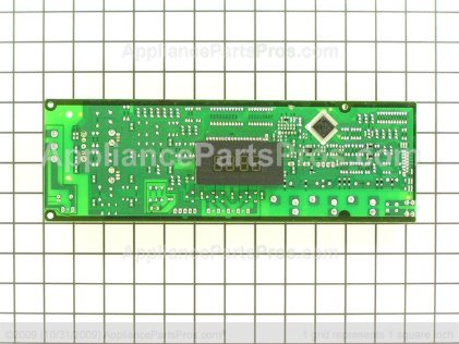

Ok, look on the first wiring diagram.
You will see L2(Red) and N(White) take a voltage reading there. Put one meter probe on L2 and the other meter probe on N and tell me what the voltage reads.
Next you will see L1(Black) and N(White) at the L.V. Trans, do the same there and tell me what the voltage reads.
Here's the clock oven control board for your model below, that's where you take those voltage readings at.
Main Control Board DE92-03045F
