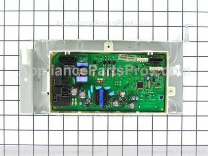

So that just leaves the control board as the culprit if the thermistor reads good at 74 to 77 degrees F at 10k ohms.
DC92-00669Y PCB
137,440
Is there a revision number on your model number tag, because I'm showing different control board part numbers based on your revision number.
If your model number is DV42H5000GW/A3-01, Here's the main control board for your model:
The control board I posted in post #7 is for DV42H5000GW/A3-00

yeah that control board is where I am as well. Except the "gradual" process of getting to here really points to a physical/clog event not a computer failure. But I'm out of ideas. Either way, those boards are more $ than I want to put into this dryer while not being certain its the issue.
