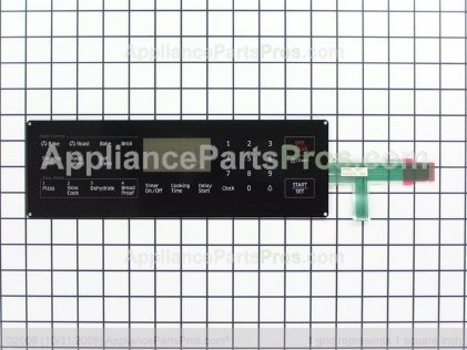

We just recently bought a house and the house came with a Samsung Stove. Last week it started giving an SE error code. We flipped the breaker to fix it and it just kept doing it. Now it wont stop beeping loudly and showing the SE code. I just am curious on if i need to replace the control panel or the membrane? Our model is NX58H5600SS/AA.
I appreciate the help :)
Thank you!
This is the part you need:
DG34-00027B Switch MEMBRANE
You can see from this thread, that fixed it:
