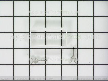

Back in January of 2020 I posted the service bulletin on this problem, and your model is INCLUDED, and the parts it says to order to fix this problem permanently.
Look at post #3 here:
Just download and follow the instructions of that service bulletin.
It also does say to REPLACE THE ICE MAKER IN ALL CASES.
Here's the ice maker for your model:
The ice maker is currently in-stock at RepairClinic: https://www.repairclinic.com/PartDetail/Ice-Maker-Assembly/DA97-13718C/4546338

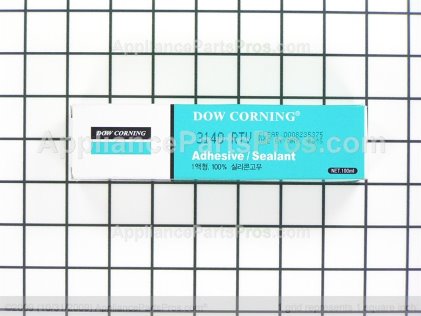

Here's the other parts it says to order below.
DA81-05595A EPOXY;3140 Rtv
DA82-02367A Assy-Y CLIP;RF9000K,Y-Clip
