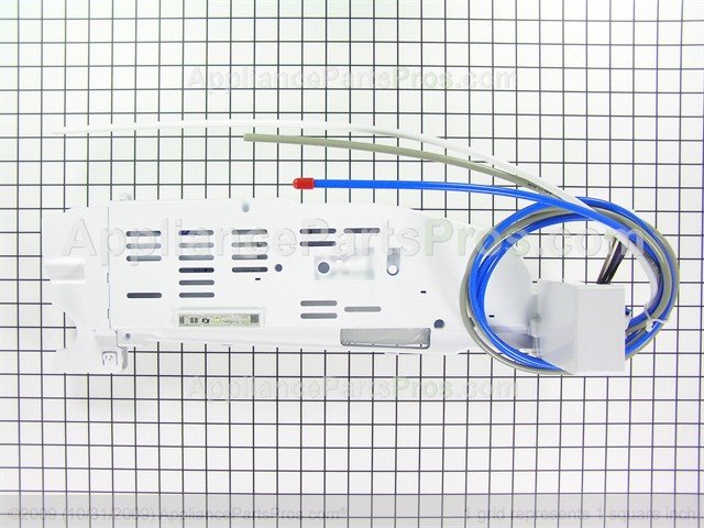

The ice maker cover is integrated into the ice bucket, I see your ice bucket is missing too.
Here's the ice bucket that comes with the ice maker cover:
Ice Bucket DA97-14474C
