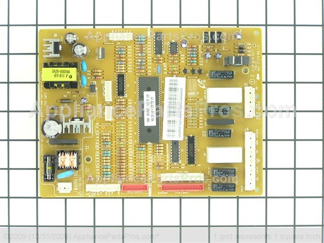

My Samsung RS277ACPN refrigerator is not performing defrosting and the condenser coil ices up until refrigerator no longer cools.
The question that I have arrived at is: Does the operation of the forced defrost function have a dependency on any temperature sensor input or other input that would prevent it from going through the defrost cycle? Any help is appreciated.
My troubleshooting to date is below.
Problem: Refrigerator condenser coil keeps icing over. Refrigerator defrost cycle is not occurring
I Replaced Refrigerator Defrost Temperature sensor as it was out of spec at room temperature (measured over 50Kohms).
I Measured Refrigerator Defrost Heater/Thermal switch resistance at control board connector to be 92.8 ohms so heater circuit appears to be good.
When self diagnostics are run (Hold Power Freeze and Power Cool for 8 seconds) The display blinks twice and then goes back to normal display. So no LED segments are held to demonstrate other problem.
At power on of the refrigerator I see 120V briefly on the white wire (R-DEF-HEAT) at the control board connector and current is drawn through the heater briefly co-incident with a relay click. So I know that the heater control circuit is working.
However when I go into the forced operation function and select forced refrigerator defrost the heater voltage comes on very briefly and shuts off.

Yes, your sensors and defrost heater seem good.
R Room Sensor 10.35K ohms ~48.2 deg F? (this does not make sense as room ambient is 65-68 deg). I assume this is the sensor at the top Freezer door hinge cover?
Yes, I believe you are correct. That does seem odd to me as well.
So the problem you're currently having seems to be the main control board, but this board is NLA.
Main Control Board DA41-00546A

Thanks. Well sounds like a new fridge then. I see on line there is a repair service for these control boards but if you have to send it in to get repaired you no longer have a refrigerator to use.
I think I resolved the Refrigerator Room sensor confusion. I believe it is room, as in compartment rather than room temperature. The ambient sensor is on a separate connector, so 48 degrees for the inside of a refrigerator that is turned off for a while seems reasonable. I will edit my post accordingly.
