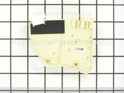

Here's the motor inverter board for your model:

Thanks for the reply and the link. I did find the link earlier. Very helpful. I've attached the Technical Information papers that came with the unit. They provide inverter resistance tests.
It's definitely a 3C2 code. I got the "3C" code when the unit stalled mid cycle, and 3C2 after going into the installation mode and checking error codes.
Of not, Samsung has a 10 year warranty on the motor, that leads me to believe the motor itself would not likely be the issue.
Last night I opened the Inverter up and did some checking based on the manual. The test of resitance test in CN6 went well(ish). I did an ohm test on the wired side of the connector and they all checked out ranging from 11.8-12.1. However, I tried to do the same on the prongs in the receiving socket and got nothing. Is this the wrong way to do the resistance test?
I checked the Hall sensor according to the diagnostic and got 1.33v and 1.35v between pins 4&2 and 4&3 respectively.
Add to this mystery, I've run a load on delicate and another on the regular cycle with the spin turned from high to medium, both without issue...
Any ideas?

I have noted it seems to be less an issue. Maybe Jake can help me interpret what I have discovered?
1. Attached Haul sensor test, passed.
2. Motor Check (Inverter) resistance test and got zero's across the board (pg. 9 of 10 says should be ~12 ohms.).
3. Motor winding test returned 12+/-0.3 ohms (paper work says these should be 6 ohms).
4. Using the attached inverter PCB test I got the following results (procedure says all results should be ~4.6 ohms):
CN6 Pins 1 2 3
CN2 Pin-1: 6.10 6.11 6.13
CN2 Pin-2: 7.09 7.10 7.11
CN2 Pin-3: 7.08 7.10 7.11
CN2 Pin-4: 4.30 4.33 4.36
Is this conclusive that my board is shot?
5. The Inverter Board haul sensor test (using the pins on the board) returned 0.98 and 1.3 ohms. I think this should have been 2-4 ohms.
6. @SPLzero Is the board you replaced the inverter or main board or both?
Any help is appreciated, thanks.

137,440
Yes, it would be the motor inverter board per your Motor Check (Inverter) resistance test.
