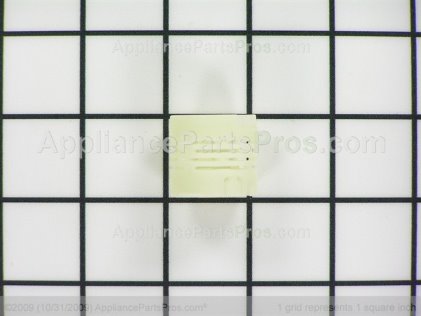

Scott_V
Feb 27, 2016
9
Elkins Park
Hi Jake and all,
Switched out the check valve...
Same result.
After running on the Express Wash cycle, stops at 16 minutes, cycles the start of the drain pump motor 3 times, then E25.
We have done all the looking at the filter and cleaning,
removing and making sure drain pump clip is in place properly,
pulling out the machine,
checking all drain hoses,
turning off power,
disconnecting electrical for a period in attempting to reset,
replaced check valve,
installing a new drain pump, pulled up on the float when no water, pump goes, with water pump does not go when pull up on float.
What else could there be?
I have attached a photo of something I think is a sensor related to the drain pump, thought I saw somewhere where this could cause an issue.
Is that the case?
The machine is not 2 years old, so thinking it shouldn't be this hard to fix.
Thanks for your help.
Best,
Scott.
137,675
That's all I have Scott, I've never been trained on Bosch Appliances, I'm just going by what others have mentioned for those 2 error codes.
You will likely need to have Bosch come out and fix it for you.
