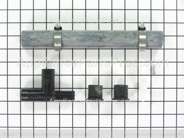

Wait, did your original drain hose have a siphon break in it?
Kit, Siphon Break 562P3
I located your parts diagram, I'm attaching it below, look on page 31--->Siphon break kit MUST be installed in drain hose if drain receptacle is lower than cabinet top of washer; Optional.

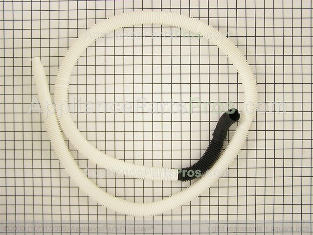

Then look on Page 30 it shows your OEM drain hose.
Here's the OEM drain hose for your model:
Hose, Drain-Ddp High Flex 39893

Okay, so the drain sink is higher than the washer or maybe about at the same level actually - what do you think? I suppose there were no issues before, except maybe there was too much lint on the washed clothes.
Besides that - the wiring looks good, I don't think anything is crossed. There's only one way to plug/unplug the thing I unplugged.
The original drain hose did not have a Siphon Kit. Just to double check I put the original hose back on and tried to run a cycle but the same problem ocurred.
Any other ideas? Thanks so much for your help already!
That looks fine.
Its just odd that this problem only started when you replaced the drain hose.
I don't know what else to suggest, sorry.
You may need to contact Speed Queen at 800-552-5475 to come out and see what's going on.
