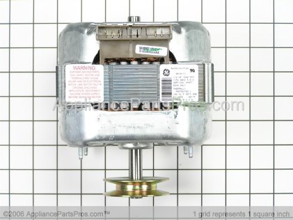

Hi Emily, from your video it seems the motor bearing is shot, with all the squeaky sound when the motor is running that direction while agitating.
While you have the front panel off, take the belt off the transmission pulley and motor pulley then see if the motor runs all by itself in that same way in the agitation cycle.
If so, then the motor winding(bearing) for the agitate cycle is shot. The motor is very expensive so it would be more wise to save the repair money for new washer in my opinion.
Here's the motor for your model:
WH49X10040 Motor
