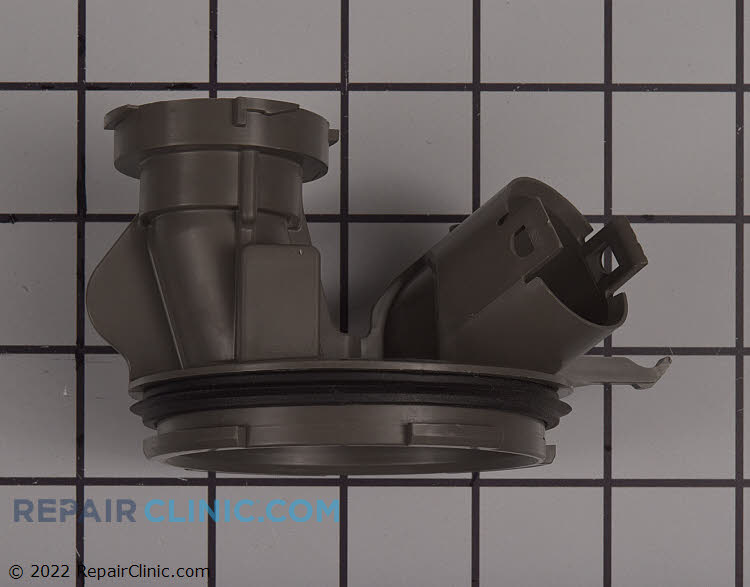

I came back to my apartment after a vacation to find my dishwasher leaking through the center of the door.
The water appears to be leaking through the vent or outlets marked with red arrows on this post:
www.applianceblog.com
These vents are clean and clear on my unit, however. What failure has occurred to allow a volume of water beyond the capacity of the overflow tray to be emitted from the unit?
The handyman in my apartment building attempted to fix the unit, but left me with pieces of poorly seated white foam at the base of the door where it meets the tub. I'm not clear if these are OEM parts or his attempt at a fix:
I can feel pieces of foam that are still there at the bottom of the door where it meets the tub, but as a renter, I'm not equipped to disassemble and inspect. The other handyman in the building came and took silicone caulk and fully covered the vents pictured in the post linked above, but admitted he doesn't know what purpose they serve. I believe they must have a purpose, though I'm not sure either.
The seal on the sides and top of the dishwasher (originally part W10524469) appears to be intact. I think these outlet ports and overflow tray are part of the inner door (originally part W10713291). However, I can't tell if there is a seal that has failed where the door meets the bottom of the tub. Is there a lower seal that could be failing?
