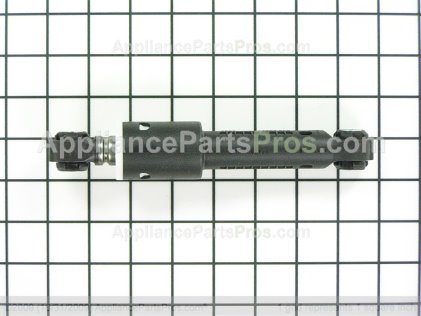

Yes, we see a lot of problems with aftermarket shocks.
Here's another thread about this:
Also look here:
Here's the OEM front shocks for your model(Each sold separate):
Shock Absorber DC66-00470A
Video included in part link.
Here's the OEM rear shocks absorber for your model(Each sold separate):
DC66-00470B Shock Absorber

My first thought (and perhaps annoying to you) is to check that you might have installed each pair in the wrong location. The pair intended for the front were installed in the rear and vice versa. Apart from some obvious failure of one or more shocks, I have my doubts this is your problem.
Front loading washer shocks are simply air dampers. These things are not complicated devices. They comprise just two components: a steel cylinder compresses a small volume of air trapped within a plastic sleeve (no springs or oil or valving). And like all dampers, their main purpose is to absorb ("dampen") the oscillation of the springs they are paired with. I can't imagine the fact that you installed aftermarket shocks would make much of a difference.
The balance ring rarely fails. Save t'shooting this expensive widget until all other suspects are eliminated.
I recommend you remove the front cover (not a casual job, I realize) and inspect the counterweights carefully. Remove both and confirm neither is broken.
Run your washer under diagnostic mode and attempt to isolate the conditions—and any peculiar noises—that lead up to the problem you're experiencing.
And finally... <pause for plaintive sigh> even relatively new spiders can break again, and cause the type of problem you have.
