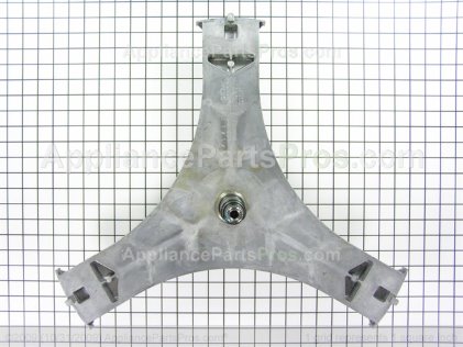

User reported symptoms: "The spinning cycle . . . . is louder, the rocking more intense and there is a smell of the motor over heating when the washer is opened after stopping the spinning manually." Any ideas what I should check?
My guess is that you have a broken/cracked DC97-14421A spider. That's a big aluminum casting the supports the entire wash basket. I suspect the smell it caused from the wash basket hitting the outer tub and "cheese gratering" plastic off it in the spin cycle.
Replacing the spider requires you to completely disassemble the entire washer. You'll also want to change the bearings & main seal while you're at it.

You'd need to remove the tub(inner) and check for cracks or broken spots on the inner tub spider arm support first. Allow yourself a few hours, its a big job to do that.

I have completed the repair, you have been very helpful and my tenant is happy. The 'spin problem' seems to have corrected itself and it purrs along quietly now while spinning. I attach a picture of the broken spider arm. Thanks!

Excellent, good find.(y)
Glad to hear the new inner tub spider arm support fixed it.(y)
Here it is for your model, in case others need it too:
DC97-16509B Assy Flange Shaft
