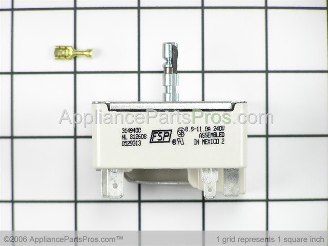

So when I looked at this range, originally the right front burner was on low regardless of knob setting. I got a infinite switch WP3149404. The old one was visibly burnt as well.
I put it in and now it does have a range of Temps, but it's more like super low to medium. At high the element is on about half the time.
I always thought the infinite switch solely controled the range of Temps, could the element or control cause this behavior as well?
