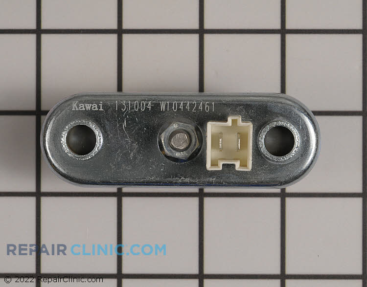

First F3E2 error I have replaced the thermistor and checked the wiring, problem is intermittent. We always use cold water, But this fails on any setting.

F3E2---> TEMPERATURE SYSTEM ERROR--->This error is displayed if the water temperature sensor value is out of range (14°F to 230°F [–10°C to 110°C]). Correct ohm reading should be 500-100K Ω.
Possible Causes
--->See TEST #10 (Temperature Sensor) on page 19
Here's the temperature sensor for your model:
Temperature Sensor W11208385

I don't understand what you mean, if you always use COLD water?
Here's the tech. data sheet below, do TEST #10
