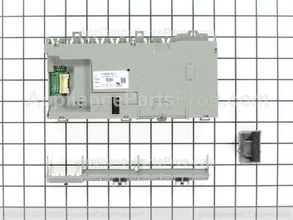

Yes, that's the problem then. Ok, disconnect power to your dishwasher and remove the control board and the plastic casing around the control board and check for any burnt spots on the control board.
Main Control Board W10597042

Thanks a bunch Jake for the instructions. The board seems to have no burn marks at all. Is there a way to rule out the touch interface (or whatever its called) if that's the culprit? Or alternatively, check the control board using a multi-meter?
139,315
Fuse Resistance Check: 1. Unplug the dishwasher or disconnect power. 2. Measure resistance of F8 Fuse and/or F9 Fuse. NOTE: Fuses are on the bottom of the Control Board but can be checked from the top side. See “Control Pinout” diagram.
If resistance is < 3 Ω, then fuse is OK.
If resistance is > 3 Ω, then fuse is open
Did you take the board completely out of its plastic casing and flip it over and look on the other side for burnt spots?
If so, and none present, I'm attaching your tech. data sheet below, look on page 9 where it says--->Won’t Run or Power Up (“Dead” Keypad/ Console)

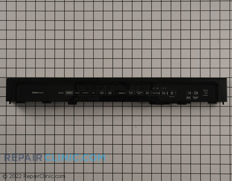

Here's the user interface for your model:
Touchpad and Control Panel WPW10350413

I hadn't taken out the board completely out of its plastic casing but I did after you pointed it out. There are no burn marks on it. While I had it out, I also checked F8 and F9 and both had <1 Ohm resistance. Although when I would touch the probes, the reading would start from 90 or 1410 sometimes and then it stabilized to lower than 1 Ohm. Not sure if thats an issue.
Does this mean the control board is fine and touch panel is the last part remaining and that must be bad or is there a way to check and rule it out as well?

Ok, put the control board back in place and all the electrical connectors back in place too, then do this test below.
- Unplug dishwasher or disconnect power.
- Disassemble door and disconnect keypad connection JUST from control board.:)
- Verify all other connections to control board are made.
- Reassemble door, but do not close door.
- Plug in dishwasher or reconnect power.
- Wait at least 7 seconds for control board to power up completely.
- Close dishwasher door and monitor control board response:
A. If control board is OK, it will respond by turning on the drain motor for 2 minutes. Replace control panel keypad(aka user interface).
B. If control board is not OK, it will not turn on drain motor. Wait for at least 10 seconds. If there is still no drain response, then replace control board or LCD display module (whichever one the keypad was connected to).
139,315

I purchased a new control board and this time the lights turned on the touch pad but when I select a cycle, it doesn't start rather the START and the little Washing light starts blinking. I can select different cycles and cancel on the touch pad.
IF I disconnect the touch pad and run the test you had mentioned earlier, it doesn't do anything.
Please NOTE that for both these tests, I had the control board and the touch pad on a wooden stool meaning that they were not properly installed and neither the door was installed. I don't know if that could be the cause but unless there are hidden sensors on the door or else where that detect this, this should not be a problem. What do you think?
