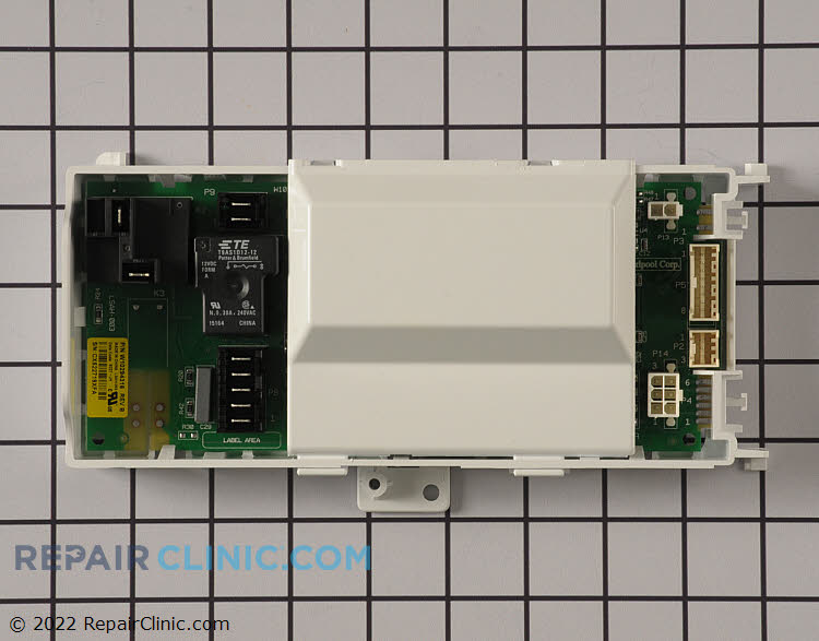

After cleaning out several pounds of lint from inside several cavities of the machine and replacing the thermal fuse, I have a running dryer. But after turning it on and letting it run for only a few seconds, a new error message of L2 flashes. Does that mean my heating element is out? I read that the error message means there is an electrical issue TO the heating element. Just wondering what I should try to diagnose next. Appreciate all the help!
After cleaning everything out and resetting everything. It seemed I had a working dryer again. My wife didn't even get a half dozen loads done and the same issue that originally caused this thread happened again. I'm guessing it is indeed the control board.

We cleaned everything from behind all the way out to the outside. It ran for a couple cycles then started doing the same thing it was originally with the sensor indicator and not running. Originally after fixing the thermal fuse, it then showed an error message of L2 and AF. Thats when we did the cleaning. I have not ran the second error code list but assuming it's going to say control board. Am I wrong?

L2 flashes if low line voltage (less than 50V) is detected at installation.
--->Check to see if a household fuse has blown or a circuit breaker has tripped.
--->Confirm the power cord is properly installed and plugged into the power outlet.
--->Check the relay connections on the machine control electronics. See TEST #4, page 6.
Main Control Board WPW10294316
Restricted Air Flow Condition
AF flashes if a restricted air flow condition exists.
--->Check to make sure the lint screen is clean, the door seal is in place, and the vent is not obstructed.
