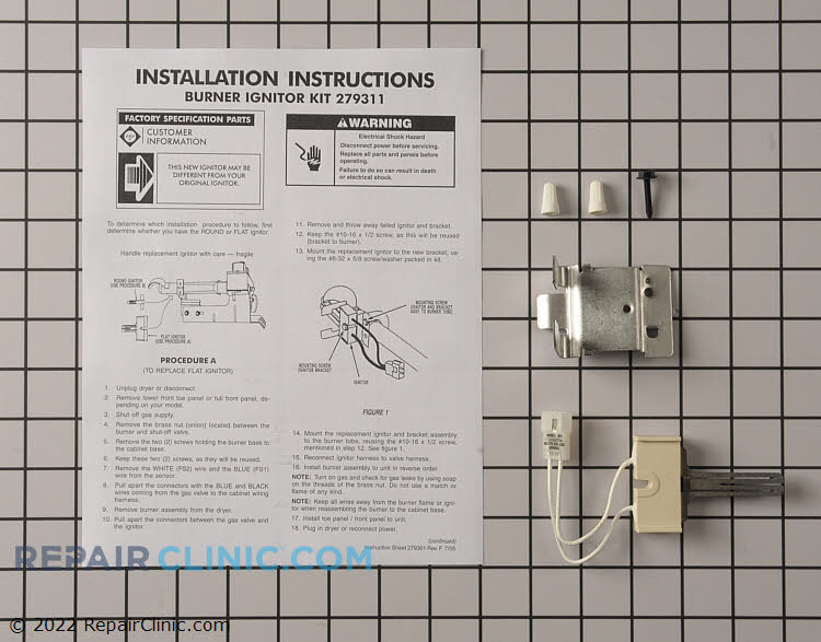

Ok, your flame sensor is good.
You can ohm test the ignitor to see if its weak.
Dryer Igniter 279311
If the igniter ohm tests in range per the video, then I'd order the gas coils.:)
