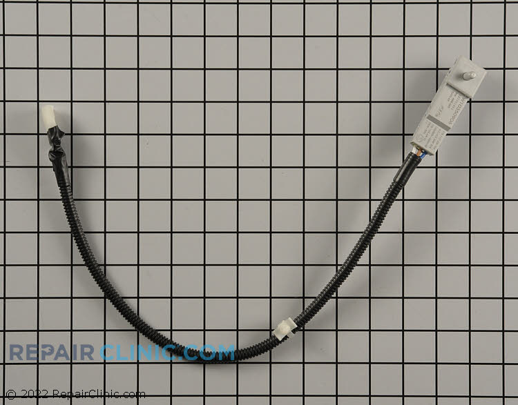

Here's the thermal fuse for your model you can order: Thermal Fuse W10909685
Watch this video to ohm test it with a multimeter: Thermal Fuse Testing
Watch this video to access it: Thermal Fuse Replacement

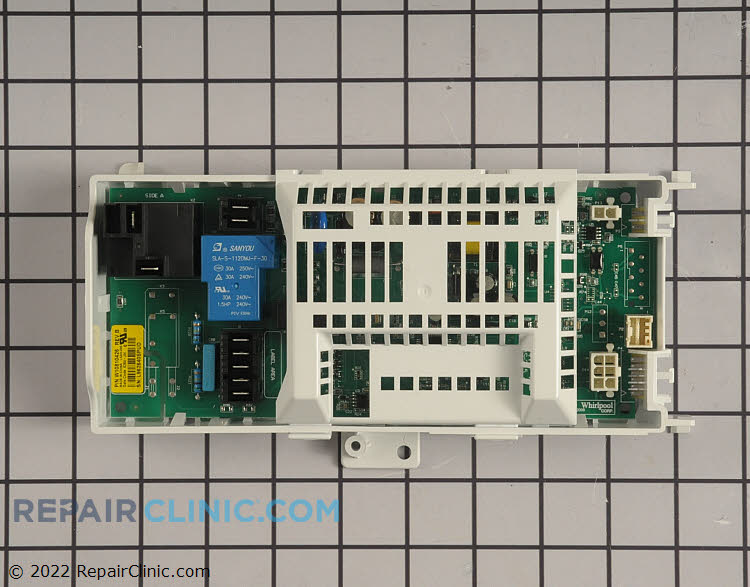

Ok, next make sure the machine stays unplugged, then get access to the control board(video included in the control board part link below) and see if you notice any BURNT components on that board.
Control Board W11537215

  1. Nothing on the control board appears burnt that I can spot

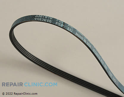

Ok, on some models they have a broken belt switch, I don't see that listed on your model, but since you have a Canadian model number, it still may be there. Make sure the dryer stays unplugged when you check for it.
Here's the drum belt for your model:
Belt 661570V
Here's the video to access it:
Brian1337
Jul 17, 2022
Toronto, Canada
Thanks. It seems like my model doesn't have a belt switch (assuming this video is showing me the right place to check). There's just a blue wire between the two terminals that the switch would normally connect to.

I didn't do all the CCU power check tests since I'm less familiar with the voltmeter functions, plus if the CCU is bad I'm not sure I'd want to spend $250-$300 for a new one vs. just getting a new dryer. But I can dig more into this if you think it'd be fruitful?
What do you think - am I running out of possibilities to fix this? Is the CCU the only thing to do at this point?
132,647
Redmond, Oregon
All the motor circuit tests (everything good there - the resistance on the "Main" winding coil was 3.7, which is slightly out of the range specified - but probably not enough to be the problem?
That should be fine.
Yes, it basically comes down to the CCU as the problem that is causing this.
