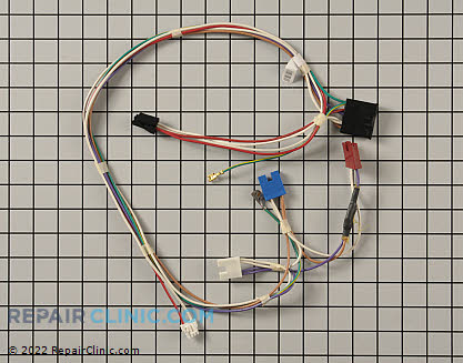

The second problem is that when water is pulled to the ice maker it causes dripping from the water dispenser. Likewise, after the water dispenser has been used it continues to drip for maybe 20 or 30 seconds. I completely removed the (what appears to be 3rd party) water filter from the fridge due to loud squealing and slow water dispensing so it isn't that. Could this be a faulty water valve situation?
There is a diode in the wire harness to the water inlet valve, I'd check that first.
Here it is for his model:
Wire Harness W11291133
Here's the single(primary) MAIN water inlet valve for your model, that the diode wire harness goes to:
WPW10238100 Valve
