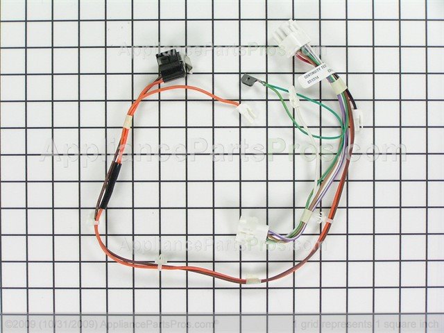

The defrost heater should of come on in that test.
Here's the defrost thermostat for your model that comes with the wire harness:
Harns-Wire WPW10290745
The round black piece is the defrost thermostat. I always ohm test that for continuity while its frosty, your meter should read 0-1 ohm. Make sure you disconnect power to the refrigerator first before ohm testing.
