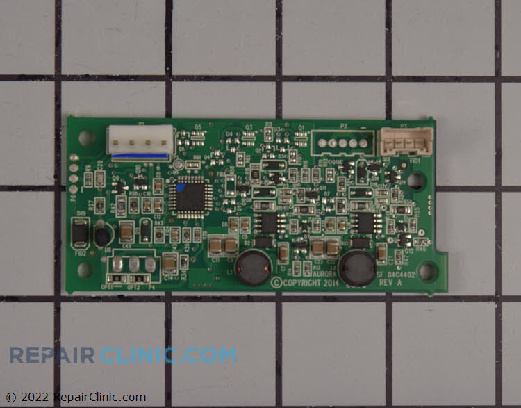

This is a 4+ year old fridge and the lights in all compartments strobe when opened. Is this something I can fix myself or do I need to get a repairman in?

This is the LED light board for your model:
Here's the photo of it:
Control Board W10830288
That board is located in the back of the refrigerator on the back exterior wall. Pull the refrigerator out from the wall, then Unplug the refrigerator, then you will see a cover over it, just remove that cover.

Then plug the refrigerator back in and open the refrigerator door, then on the LED light board--->Volt test between P1 Pin 3(yellow wire) and P1 Pin 4(black wire) and tell me how many volts you get.
