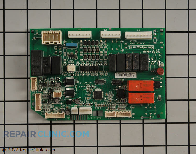

I would like to ask if anybody can help or recommend next step of diagnosis.
My fridge stopped cooling completely for both, fridge and freezer, no cold air at all.
I can feel fans inside the fridge and freezer blowing air, but not cold, just room temperature.
I can hear the compressor running.
All lights inside the fridge working.

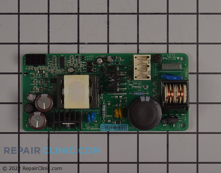

2-TEST THE COMPRESSOR AND THE INVERTER BOARD
Test compressor--> I get equal 13.6 ohms around the 3 terminal of the compressor
Test the voltage from the control board to inverter board--> 7.5 DC voltage and 122 AC voltage to the inverter board
I can confirm I hear the compressor working all the time and the fan on its side working too.
3-Mian board and power board
On the power board:
Power Board W10830278
P1-1 - P1-2 = 120 VAC constant. GOOD
P1-3 - P1-4 = 120 VAC constant. GOOD
P2-1 - P2-4 = 14 VDC constant. NOTHING
P2-2 - P2-5 = 14 V DC constant GOOD
P2-3 - P2-6 = 14 VDC constant GOOD
On the main board:
Main Control Board W10843055
P1-1 - P1-2 = 120 VAC GOOD
P14-6 to P14-7 = 14V constant GOOD
