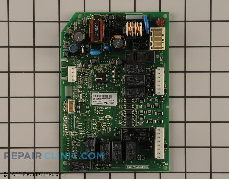

For Question 1--->Pull the refrigerator out from the wall, remove the cover from the main control board and have someone press the ice dispenser lever while you take a voltage reading at these Pins: P3-7(Blue wire) to P3-8(Gray wire) you should see 140 volts DC.
If you do get 140 volts DC and the auger motor is not running, and the wires to the auger motor are good, then your auger motor is bad.
Here's the auger motor for your model:
Auger Motor W11202789
If you don't get 140 volts DC then your main control board is bad.
Main Control Board W11088499

as for question 1 - I peaked behind the refrigerator assuming that when you said pull it away from the wall, the access cover to remove was on the back. I didn't see any access panels - perhaps I should look again. You tube has always been my friend, but for this - I'm not seeing anything about how to access the auger moter, how to replace it, also I can't find a repair manual that would give instructions... is it all done via the control panel on the front? .

The control board is located in the back of the refrigerator. The auger motor is in the freezer door. You take the voltage reading from the control board.
This video gives you the general idea of where the control board is located:
