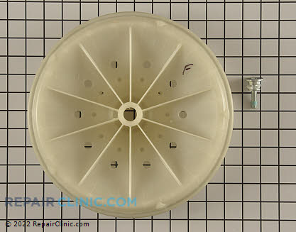

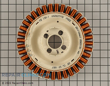

You may have a cracked rotor or stator, I'd check that first.
Here's the rotor for your model:
Rotor Assembly 280146

Here's the stator for your model:
Stator Assembly W10419333

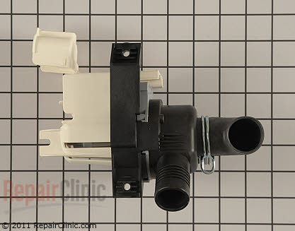

How long does it take the washer to drain? That may be the problem, it should take no longer than 90 seconds to drain.
If its taking longer than 90 seconds, First check for a clog in the drain pump, that would cause this issue.
Drain Pump W10536347
Watch this video to access/replace it.

I spent some more time today on the problem and after pulling the basket, there wasn't much water left. I did go into diagnostics right before I disassembled the parts and had the drain pump run for 90 seconds just to be sure not much water would be left to clean up.

Next step is to remove the water connections and tilt the washer forward to look underneath and see if anything stands out with the rotor or stator based on your suggestion.
