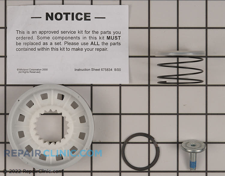

Here's the clutch(shifter coil) assembly for this model:
W10754448 Clutch
Did you also replace the Shift Actuator?
Here's the Shift Actuator(also called Slider) for your model:
Shift Actuator W10734521
