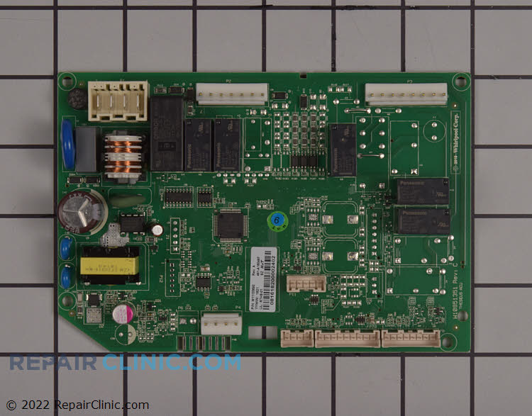

You have 3 parts that control the defrost cycle: Defrost Thermostat, Defrost Heater, and Control Board. You will need a multimeter to ohm test.

You will need to ohm test the defrost thermostat for continuity while its still covered in frost, and ohm test the defrost heater too. Unplug your refrigerator first!

If both the defrost thermostat and defrost heater ohm test good, then we know the control board is the culprit.
Control Board W11174836
