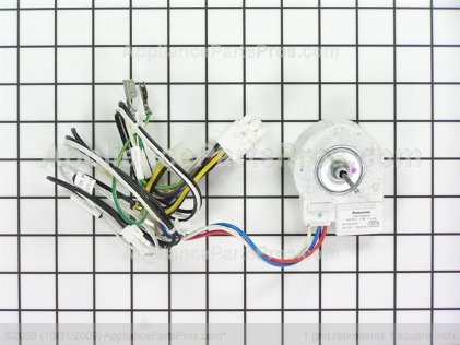

Freezer 17°
Normal would be 0 degrees F. The fridge temp is too warm as well, that noise could be the refrigerator evaporator fan motor.
Ok, you will need to remove the back panel inside the freezer and see if the evaporator coil is completely frosted up and ALSO see if the freezer evaporator fan motor is running.
If that freezer evaporator fan motor is NOT running--->P14-1 and P14-2 are the FC(freezer compartment)evaporator fan motor pins on the main control board(located on the back exterior wall of the refrigerator).
I'm attaching your tech data sheet below, look at the very bottom in that chart where it says MAIN CONTROL see P14-1 and 14-2--->14VDC--->FC FAN MOTOR OUTPUT ACTIVATE SERVICE TEST 3, STEP 2. Do that SERVICE TEST 3, STEP 2 and that will activate 14VDC on those pins.
Here's the freezer evaporator fan motor for your model:
W11109595 Motor-Evap
This video gives you the general idea of how to access it:
For the refrigerator evaporator fan motor. There is a video in the part link to it below.
On the main control board P14-3(YELLOW) and P14-4(RED) are the wires to the R(refrigerator)C(compartment) EVAP FAN MOTOR. ---> RC FAN MOTOR OUTPUT ACTIVATE SERVICE TEST 3, STEP 2. Do that SERVICE TEST 3, STEP 2 and that will activate 14VDC on those pins.
Here's the FRESH FOOD EVAPORATOR FAN MOTOR for your model:
Evaporator Fan Motor W11087438

I ordered the fresh food evaporator fan today, it'll be here Saturday. The other fan motor you listed does work, should I replace it as well?
