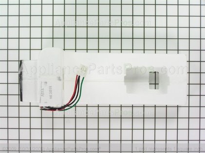

Can you tell me what the white thing is under the IM mold that is on the BK/WH wire. I am still on the hunt for my problem.
I have monitored the 120v from the control board to the connector under kick panel as long as I do not have it connected to the harness running in the freezer door I never loose the voltage.
I have now disconnected the IM harness at top inside freezer compartment to see if the voltage drops out after a period of time. It looks like when ever the IM is plugged into harness I loose my 120v within 1/2 hour.
Jake, I think I have it narrowed down. Whenever the Ice Maker is plugged into harness after about 5-7 minutes the voltage drops out. I unplug the IM from harness and about 1/2 hour the voltage comes back. I figure there is something in the IM module board pulling to much current and opening the thermal fuse.
That white part is the in-line thermal fuse, if it was bad you would never get 120 volts at the ice maker, its not a resettable thermal fuse, When it blows out its out for good.
Ok thats what I wanted to know. I think my IM motor is bad. When checking it I am getting 72.8 ohms and it should be between 4400-8800 according to spec sheets.
Ok, good find!
They don't sell the ice maker motor separately, it only comes with the ice maker module assembly.
Here's the ice maker module for your model:
8201515 Icemaker Motor Module
There is a "how to" video in the ice maker module part link.
