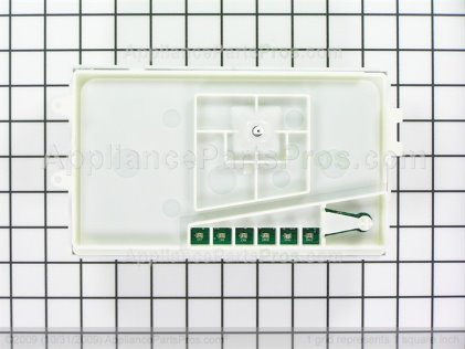

Found R244 resistor. Was on back of board. Looks perfect. No signs of being blown or burned. Reassembled everything and still fails manual test. Pump does not come on. The 3 lights flash indicating the pump is being tested but it does not come on. What does that mean? The board itself is faulty? Somewhere I can see visually?
John.
137,440
Check for 120 volts at the drain pump electrical connectors when running the drain pump test.
But first, look on page 18:
8. Visually check the electrical connections at the drain pump.
--->If visual check passes, go to step 9.
--->If connections are loose, reconnect the electrical connections and repeat step 2.
9. With an ohmmeter, check harness for continuity between the drain pump and main control. See chart below.
If your wiring is good and your not getting 120 volts to the drain pump when it should be running, then yes the control board is bad.
W10634026 Cntrl-Elec
