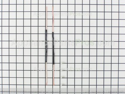

This GE washer has the fuse link. It is listed on the Controls and Backsplash parts list: Controls & Backsplash parts for GE WPRE6150K2WT
You won't find the fuse in the diagram, but it's in the parts list.
Here it is:
WH49X10055 Kit-Fuse Link
You first need to do the continuity check as per Shawn's web site to rule out the fuse link and lid switch. If these are good and there is no flashing LED on the inverter board, then the motor/inverter is bad. This is a very common problem with this washer design. Even if the fuse link is bad, it is recommended to replace the motor/inverter. The motor/inverter has been redesigned and the replacement requires removal of the fuse link. A jumper and instructions come with the new motor to remove and jump out the fuse link. I would also check the mode shifter. You should have 98 ohms across the plug for the mode shifter.
