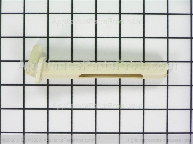

Thank you Jake- I checked the fill tube as per the video instructions you provided and it was not frozen and appeared to be clear and free of any debris. One thing I did not do was remove the clear water tubing from the back of the inlet housing, since i was able to remove the fill tube without that step. Just wanted to mention that incase it was necessary for troubleshooting purposes. What would you recommend next?
